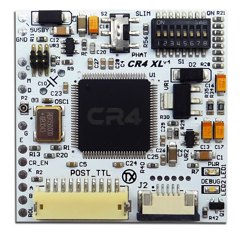

  • CR4 XL
  • CR4 TRINITY QSB KIT
  • DOUBLE SHIELDED PRO CPU RST CABLE - SLIM
  • JR PROGRAMMER V2 (You can use a v1, v1.1 or a NAND-X and even a DemoN)
The CR4 XL Board comes with wires and tuning caps 10pf, 22pf, 30pf, 47pf, 68pf, 82pf, 100pf.
I personally like to use the double shielded pro cables that Xecuter makes because it gives a perfect grounded line so you are guaranteed a clean wave.
DEFAULT DIP SETTINGS (S1):
This will give you dead center timings for Corona. Feel free to set the 3 dip to OFF and/or to add a CAP to get the maximum performance. You really can't go wrong it's a pretty solid setup.
POSTBIT JUMPERS (P1):
These fine tune the resistor on Postbit. The jumper should be set to 0 Ohms by default. In a very few minor instances a 10Ohm or 100Ohm resistor was required to shape a perfect wave.
This is the QSB kit for Corona installs. The CR4 XL code was designed and tuned with these installed and are highly recommended to ensure a perfect install.
They also come with all the necessary connectors for NAND-X, JR-Programmer, USB COMMS Cable, RATER etc[/color]
